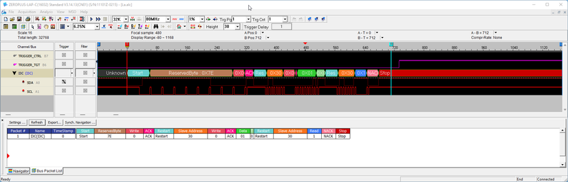

Currently I'm playing around with the I3C peripheral and I try to implement a sort of "eeprom" interface on a I3C target where I have 10 slots which I want to be able to address separately.
So on the controller side I have this function:

Now in the error handler i try to start the transfer belonging to that slot. But probably it finishes to late the peripheral already NACK's the read. Would it be possible to implement a HAL_I3C_Tgt_ReceiveTransmit_IT something?
PS. I tried removing the printf's in the interrupts to make it faster, but with no success.
PS2: while looking with the logic analyzer I see why it's not working. The TRIGGER_TRT high is when the interrupt / ErrorCallback is executed. So it's way to long and way to late for what I want to accomplish. I'll try and create my own function...
