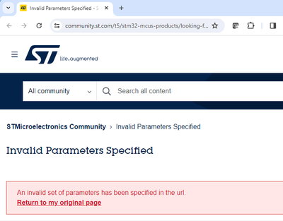

2024-02-05 3:21 AM
@mƎALLEm wrote:Hello,
As I said in this thread https://community.st.com/t5/stm32-mcus-products/looking-for-registers-informations-to-configure-stm32l0-series/td-p/635100,
The forum has broken that link:
(probably due to the trailing comma?)
Try:

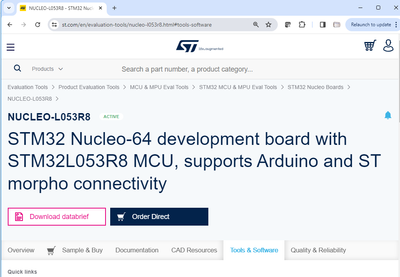

2024-02-05 5:09 AM
For the NUCLEO L053R8 board, go to the Product Page, and look under 'Tools & Software':
https://www.st.com/en/evaluation-tools/nucleo-l053r8.html#tools-software

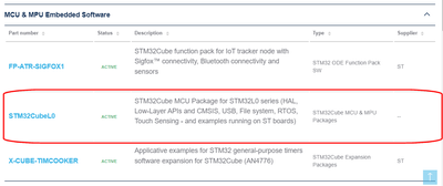

Look at the 'MCU & MPU Embedded Software' section - the STM32CubeL0 pack will have what you need:
https://www.st.com/en/embedded-software/stm32cubel0.html
