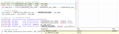

Hi All,

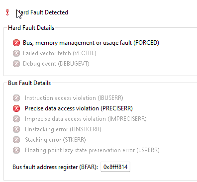

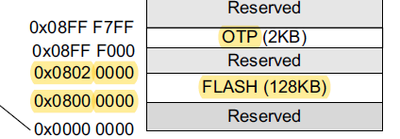

Today I received two NUCLEO-H503RB boards, but when trying to get the ADC calibration values the processor HardFaults. According to the datasheet it's the correct address:
Also when trying to access it with the debugger it fails
Also the temperature sensor calibration seems defective.
Something I'm doing wrong or are Nucleo's not calibrated or something?

Hello Nick,
The hardfault when trying to get the ADC calibration values of the STM32H503 series could be due to the fact that these values are located in a read-only area. By default, all the AHB memory range is cacheable. For regions where caching is not practical (like OTP, RO), the MPU has to be used to disable local cacheability. This information is mentioned in the Reference Manual. If you're trying to access these locations without disabling cacheability, it could lead to a hardfault. Please ensure that you're correctly configuring the MPU to disable cacheability for these regions.

was called after enabling the cache  (HAL_ICACHE_Enable()) and fall in the hardfault.
So please disable the cacheability where caching is not practical (OTP, RO, data area) as described in the referance manual.
