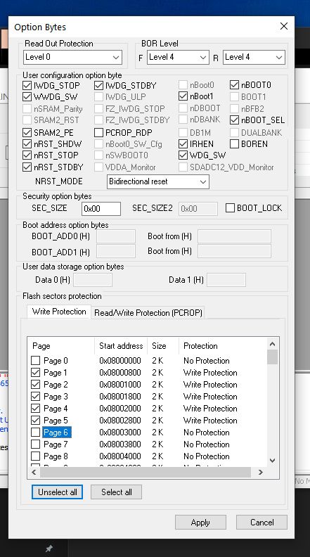

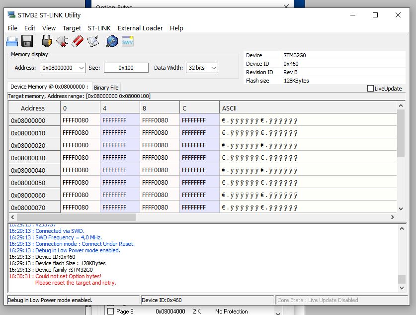

Hello, MCU bricked after I tried to remove write protection. Now when I read the flash it shows only 0xFFFF0080. Read the full description bellow.
We are making new project using STM32G071.
We use serial communication custom bootloader so we can update firmware online using our internet gateways (this is other our product).
So in order to protect the bootloader from unintentional write we are locking the first 6 pages where is located the bootloader. However because we are still in development phase I need to occasionally reprogram the prototype with custom programs. Now this is when the problems start.
The first thing that I notice after the project started is that I couldn't remove the write protection from the option bytes of all 6 pages simultaneously. I found a procedure that works:
1 remove the write protection from page 0;
2 erase the page 0
3 remove write protection from pages 1-5
4 full flash erase
This was working fine until now. Today I tried to erase again but on the second step - erasing page 0, the MCU just bricked. After this we tried mutliple ways to erase the flash. We tried using ST-link utility and ST-link, we tried using CubeProgrammer with ST-link, we tried using Segger J-FLASH with Segger Flasher and still the problem remains. My colleague develop other project using the same MCU, he also was using the same erasing procedure but today he tried too, and he stucked at step 1, he cant remove the write protection from page1.

//Write protection locking procedure
FLASH_OBProgramInitTypeDef OBInit;
HAL_FLASHEx_OBGetConfig(&OBInit);
if((OBInit.WRPStartOffset == 63)&&(OBInit.WRPEndOffset == 0))//i.e. no write protection.
OBInit.OptionType = OPTIONBYTE_WRP;
OBInit.WRPArea = OB_WRPAREA_ZONE_A;
OBInit.WRPStartOffset = 0;
OBInit.WRPEndOffset = 5;
HAL_FLASH_Unlock();
HAL_FLASH_OB_Unlock();
//ERASE?
HAL_FLASHEx_OBProgram(&OBInit);
HAL_FLASH_OB_Launch();

With the help of ST support, I will share the solution of this problem to you.
Set the option byte PCROP_RDP to 1.
Set the read protection to Level 1 (BB)
Set the read protection again to Level 0.
This procedure force reset the flash.
