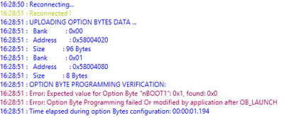

I am using a Wio-E5 mini devboard by Seed-studio and an ST-Link/V2 to program it.
After setting the Read Out Protection to AA, I was able to read and write from and to the memory and do a mass erase.
However, programming from CubeIDE always failed. I was not able to find out why exactly it failed, but got frustrated after a while and since it felt like I could always reset by doing a chip erase, I set all user configuration option bytes to zero to see what it does.
Since then, the uC seems to be bricked. I can still connect to it and (supposedly) read the memory, but I am unable to write any data to it, be it Options Bytes, trying to erase selected sectors, doing a full chip erase or uploading a hex file.
The Core State is always halted.
When trying to write any options byte, I get the following error (here an example trying to set the nBOOT1):
The error when I try and do a mass erase:

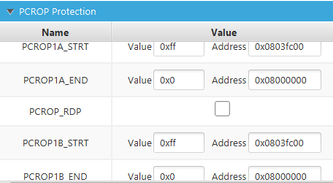

PCROP protection has the following values:

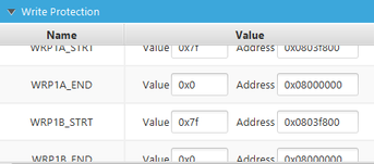

Write Protection has the following values:

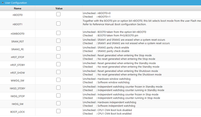

And to make it complete, this is my bodged user configuration of the option bytes.
