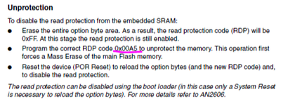

Not sure, but something goes wrong and I think the information block was erased only – without programming afterwards
“The value of an option is automatically modified by first erasing the information block and then programming all the option bytes with the values contained in the FLASH_OPTCR register.”
RDP is now 0xFF and cannot be set to level 0 (no protection) again.
After reading a lot of forum entries here I also tried the re-program RDP by the command line interface

The RDP level reading as FF can mean that the chip is actually on level 2 and the CubeProgrammer cannot even read option bytes. CubeProgrammer tries to be optimistic and behave as if the level were 1. It this cannot recover to level 0, the level probably is 2. To the soldering station.

Did you also try writing 0xA5 with cli ?
(No guarantee -- what will happen.)

I will try 0xA5 on Monday (home office today) – but I think this value is valid for other chip series only.
