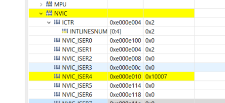

I was happily developing some ADC+DMA routines for my stm32f205 and suddenly my MCU started to freeze.
I am able to connect, erase, and flash binaries with stm32CubeProgrammer trough an ST-link.
After erasing multiple times my STM32F205 with stlink and STM32cubeprogrammer, i am using as debugging code a simple blink programm autogenerated with cubeMX with:
internal clock
SW debugging
and my led pin.
This program is also failing to execute.(it does execute no problem in my nucleo-f207 board)

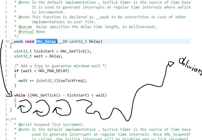

0693W000008wIOnQAM.pngWhen launching the debugging session i realised the HAL_Delay() function is leading the code to a weird flash non mapped in .elf memory location.
__________________________________________________________________________________

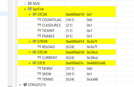

systick before hal_delay():

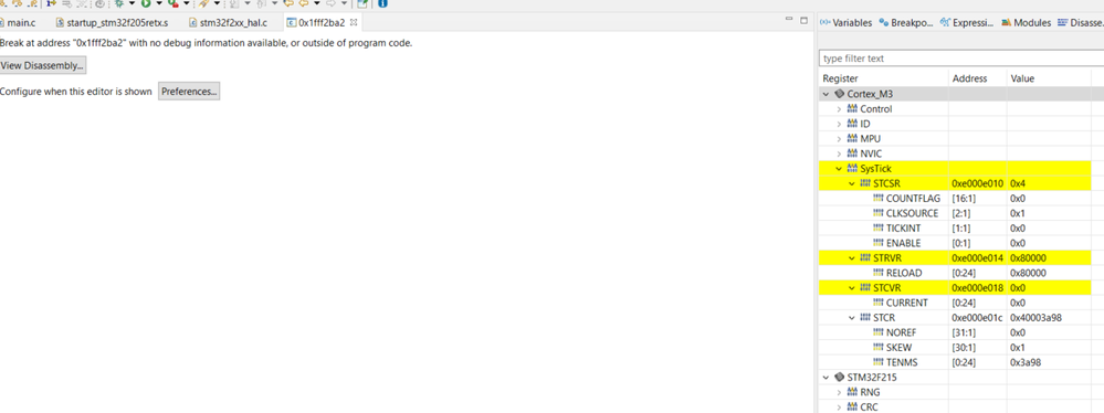

0693W000008wIWXQA2.pngsystick after werid jump to memory and debugger looses track of where the code is running
0693W000008wIWwQAM.png nvic_iser4 shows that value when everything goes south..0693W000008wIh1QAE.png
if i comment out the hal_delay function the blink works....
