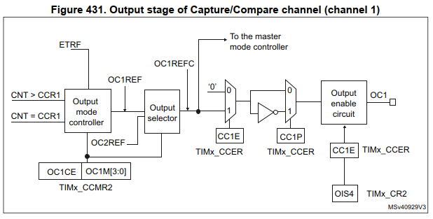

Sorry, by "wait to be triggered again" I meant wait for CNT to reach CCRx again. That is, does OCxREF keep state behind the output mux? Or does forcing the output compare output to inactive clear OCxREF as well?

I don't understand. What do you mean by "output mux"?
OCxRef is the signal which is result of the Compare module, it is basically a latch controlled by the combination of Mode set in CCMRx.OCxM and the result of the CNT-to-CCRx comparator. Basically it's a latch. If you set OCxM to Force Low, OCxRef is set to low. If you then change OCxM to High/Low on Match, OCxRef will not change until a compare match occurs.
‎2021-03-08 5:38 PM
Okay, thanks, that answers my question. This is the diagram shown in the reference manual:
What I called the "output mux" is labeled "Output selector" here. Or that plus the rest of the chain.
‎2021-03-09 12:00 AM
I see.
That "selector" basically performs the AND/OR with a neighbouring channel's output in the Asymmetric and Combined modes.
The latching happens in "Output mode controller".
This is an evolutionary thing. Compare the same diagram in older STM32's RMs, e.g. RM0008 (that's for 'F1, the oldest).
