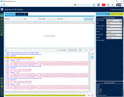

  4. After successful flashing, I powered off the MCU and then tried to connect using STM32CubeProgrammer.
  5. Failed to connect.

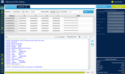

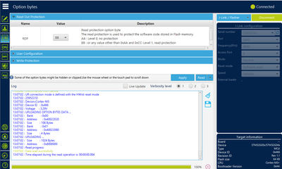

After it bricked, I tested with a new MCU and flashed the same Hex file. It worked normally. (STM32CubeProgrammer showed flash memory values as AAAA....AAA, and the Option byte page showed Read protection set to 0xBB).

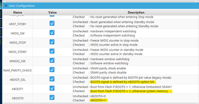

Note: I found that the default option byte setting does not use Boot0 but nBoot0, meaning it might not be possible to enter System memory using nBoot0?

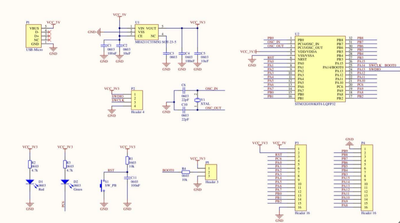

This is the schematic of the MCU I used for testing.

Since nBOOTSEL = nBOOT0 = 1, the chip will always boot to user flash and ignores the state of the BOOT0 pin.
Connecting NRST to the debugger would allow you to connect under reset, which would be another method to recover the chip.
