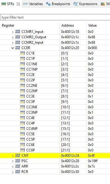

CCER content is incorrect - CC3E bit is not set, so CH3 PWM output is disabled.
You don't need to set the interrupt priority to 0 - it's the default after reset.

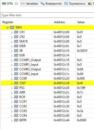

‎2022-09-02 11:35 AM
Read out and check/post content of TIM and relevant GPIO registers.
> Timer 1 has more features so we are guessing that there is another initialization that needs to be done.

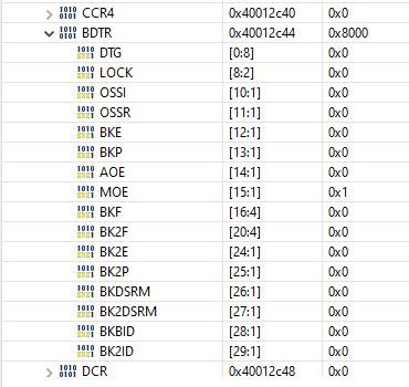

Timer1 needs BDTR.MOE bit to be set, but although I don't understand the Cube/LL gobbledygook, it appears that the EnableAllOutput() function might've set that. We'll see that anyway when you post the registers content.
‎2022-09-02 11:40 AM
‎2022-09-02 11:47 AM
Looks like that bit is set. We are only using the Low Level drivers because the G0 is in there and we don't use any of the Cube specific code generation.

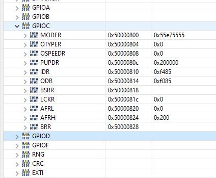

‎2022-09-02 5:07 PM
This looks OK. Now check the GPIOC registers.
What hardware is this? You can check is PC10 if properly connected by setting it as GPIO output and toggling in software.​
Btw. isn't PC10 one of those USB Power Delivery pins?​
JW​

‎2022-09-03 1:42 AM
Nice catch, gbm!
Indeed. Instead, CC3NP is set, in the "forbidden" combination with CC3P being zero [EDIT] not forbidden for Output [/EDIT]
‎2022-09-06 6:21 AM
Modified the TIM_OC_InitStruct to the code below and the PWM is now present. So the LL_TIM_EnableAllOutputs(TIM1) call just before the main loop enables a different output? What is the proper way for starting/stopping the PWM once the control is running?
The comments in the definition of the LL_TIM_OC_InitTypeDef structure state that the uint32_t OCState can be modified later by "This feature can be modified afterwards using unitary functions @ref LL_TIM_CC_EnableChannel() or @ref L_TIM_CC_DisableChannel()"
TIM_OC_InitStruct.OCMode = LL_TIM_OCMODE_PWM1;
TIM_OC_InitStruct.OCState = LL_TIM_OCSTATE_ENABLE;
TIM_OC_InitStruct.OCNState = LL_TIM_OCSTATE_DISABLE;
TIM_OC_InitStruct.CompareValue = ((timxPeriod + 1 ) / 2);
TIM_OC_InitStruct.OCPolarity = LL_TIM_OCPOLARITY_HIGH;
TIM_OC_InitStruct.OCNPolarity = LL_TIM_OCPOLARITY_LOW;
TIM_OC_InitStruct.OCIdleState = LL_TIM_OCIDLESTATE_LOW;
TIM_OC_InitStruct.OCNIdleState = LL_TIM_OCIDLESTATE_LOW;
LL_TIM_OC_Init(TIM1, LL_TIM_CHANNEL_CH3, &TIM_OC_InitStruct);
