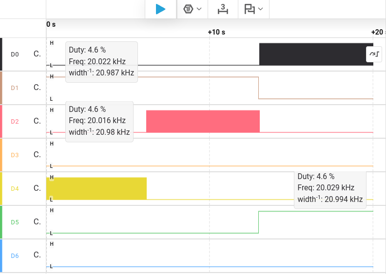

6.16.1:
  • HRTIM1 with slave-timers A,B,E are configured to output 6 PWM-signals with dead time configuration and complementary mode for CH2 of each timer.
  • The output on the logic analyzer is as expected. It shows a duty cycle of 4.6% on CHA1, CHB1 and CHE1(Picture 1 below).
Picture 1Picture 1

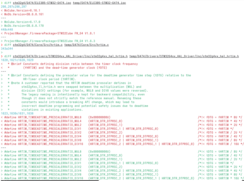

6.17.0:
  • The output on the logic analyzer is not as expected. It shows a duty cycle of 4.6% on CHA1, with CHB1 and CHE1 being inverted(Picture 2 below).
Picture 2Picture 2

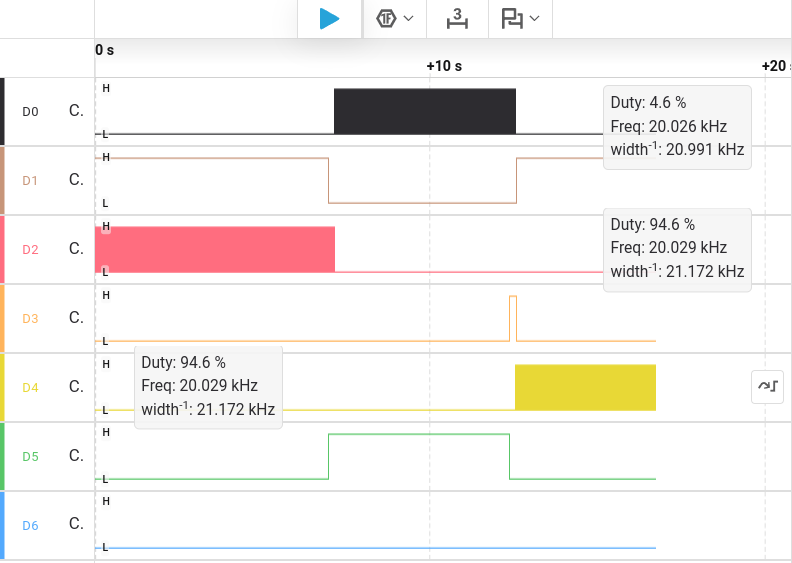

Difference in files and a mention of a customer report:
When looking at the difference between the .ioc, hrtim.c and stm32g4xx_hal_hrtim.h in the terminal(Picture 3) there is a few things to remark:
  • There is as expected no difference in the .ioc-files and there is no difference in the hrtim.c/.h files
  • There is a mention of some swapped values, could this be a cause for the problem?
Picture 3Picture 3

Hello @EchoExplorer
I am moving this question to the appropriate team for additional guidance.
PS :A known limitation has been detected in the HRTIM of the STM32G474. Please see the link below.
Solved: HRTIM1, TIMA output2 configuration issue - STMicroelectronics Community
THX
