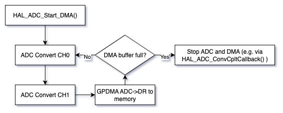

STM32H5 ADC DMA HAL_ADC_ConvCpltCallback Called Early
I used the STM32H533 Nucleo board example project ADC_MultiChannelSingleConversion as a reference for this code. The actual project is running on an STM32H523.
I am attempting to have a software-triggered array of ADC reads across two channels using the GPDMA. [Edit: for clarification, multiple conversions across a sequence of 2 channels, not just a single conversion]. The plan is to be alerted via interrupt callback that the sequence (triggered by HAL_ADC_Start_DMA) is complete. I do not want the ADC to continue to sample or overwrite the data in the buffer, so I am turning off the ADC in the callback.
void HAL_ADC_ConvCpltCallback(ADC_HandleTypeDef *hadc)
 HAL_ADC_Stop_DMA(hadc);
The issue is that this callback is being triggered after every two-channel sequence is completed, instead of once after the DMA buffer is filled.
The system does not generate any DMA complete or half complete callbacks in this configuration.
Here's what appears to be working:
  • ADC conversions are triggered correctly
  • DMA is used to move data from ADC peripheral to memory correctly
  • Continuous conversions work as intended, only requiring one software start
Here is the relevant code with most boilerplate CubeMX comments removed for brevity:

Any assistance or advice on this would be greatly appreciated! I will be as responsive as possible for any follow-up questions.

Hi Karl, thanks for the reply! Perhaps something I did not clarify well was that I'm trying to do more than one ADC conversion at a time using DMA peripheral to memory. When I set it up this way, it appears to only perform one conversion then stop. If I disable the linked list configuration but keep continuous conversion enabled, I do have the option to use HAL_ADC_ErrorCallback() to halt the ADC, but that doesn't seem like an ideal solution.
So this reply seems opposite of your original post.
Maybe a flowchart would clear up what you really want to happen?

Thanks @Karl Yamashita and @Saket_Om, both pieces of information were helpful! I reviewed both responses and got the DMA configured correctly for linear mode (not circular mode) with continuous conversions and DMA requests. The issue remained that HAL_ADC_ConvCpltCallback() was being called far too early, pre-empting the ADC and DMA from completing the set of conversions and transfers. It turns out that the callback was occurring after every conversion via the HAL_ADC_IRQHandler(), as well as after completing the DMA transfer via ADC_DMAConvCplt() (which is automatically mapped as the hadc->DMA_Handle->XferCpltCallback in the HAL_ADC_Start_DMA() call). The use of HAL_ADC_Stop_DMA() in the callback was still necessary to halt the ADC. The offending line was MX_ADC1_Init():24 above, ADC_IT_EOC should not be enabled here:
 __HAL_ADC_ENABLE_IT(&hadc1, ADC_IT_EOC | ADC_IT_OVR);
Here is the resulting code:
