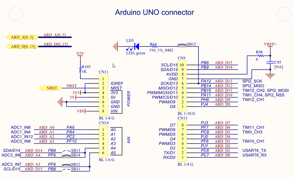

I have a problem with CAN peripheral on this board. I tried the CAN Networking Example from the EVAL board and changed the pin configuration to fit to the Arduino connector.
I found some possible pin configurations:
CAN1_RX on PA11 -> D10
CAN1_TX on PA12 -> D13
CAN1_RX on PB8 -> D15
CAN1_TX on PB9 -> D14
I added an external transceiver from Waveshare (https://www.waveshare.net/w/upload/8/82/SN65HVD230.pdf) and tried every possible pin configuration.
The problem is, that there is no signal on the receive pin, so there is no acknowledgement on the physical bus. If I set the CAN peripheral to Loopback mode, then the messages are transmitted, otherweise I will get an error.
The bus termination is correctly set with 2x 120 Ohm resistors on the ends.
The transceiver board is powered from the Arduino connector. I tried 3,3V (because it's a 3,3V transceiver) and 5V (transceiver is 5V tolerant), but there is no difference.

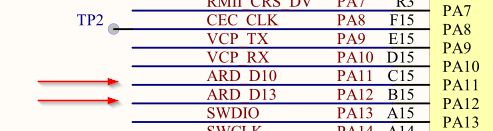

Check the schematics and solder bridges, etc. PA11/PA12 sound like USB pins..
Check pins as GPIO toggling high/low.
Sorry don't know your history, first post..​
Yes it's my first post with this account. Have a new job, so my old account is not working anymore ;)
GPIO read and write on these pins are working as expected. I measured the output voltage levels with an oscilloscope and debugged the input levels during pin reading.
I've added a picture of the Arduino connector and the pinout of MCU.
