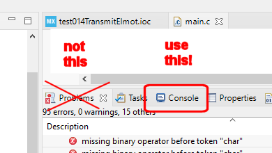

‎2022-02-07 12:22 AM
@Community member​ "The actual build log, and specific error details might help gain some perspective here"
The "actual build log" will be found in the 'Console' window:
"If you include a .H from a .C file it might not get the name-mangling done"
+1
Check that it is being compiled as C++ - not C
