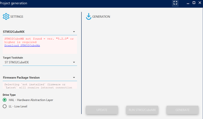

DKM
I found out that the original firmware was built using Motor Control Workbench 5.4.8.  I have the .stmcx file and can load it.  When I try a generate I get an error that STM32CubeMX not found - ver. "5.2.0" or higher is required.
However I have STMCubeMX 6.14.1 installed.  Any ideas why it cant find it?

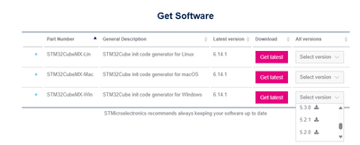

GMA
Hello @DKM.,
You can find it here.
If you agree with the answer, please accept it by clicking on 'Accept as solution'.
Best regards.

DKM
Hello @GMA,
I have the STM32CubeMX software installed.  Its the latest version 6.14.1.  The problem is that the MotorControl Workbench tool v 5.4.8 does not find it installed.
