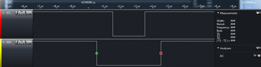

I'm attempting to talk to two devices, a barometer (MS5611) and a magnetometer (HMC5883L), using I2C with DMA on an STM32F4. The barometer runs on a timer (10ms), while the magnetometer runs through an interrupt line.

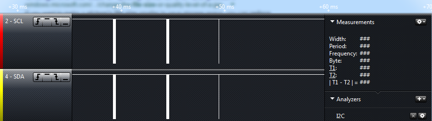

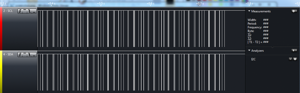

The slaves work well together, communicating only when the other isn't as verified by a logic analyzer. However, occasionally (~ every 20 secs), when the MCU attempts to write to the barometer the start condition is immediately followed by a stop condition. No address is sent, it is a void message! I have attached pictures below.
I2C working nicely until the last part:
Zoom in on the last three communications. The first is a barometer write followed by read. The second is a magnetometer interrupt triggering a write followed by read. The last is the faulty barometer communication.
This is a close-up of the last faulty communication. You can see that SDA is low for 4us, which is slightly longer than usual.
This issue causes the I2C to timeout at the I2C_WaitOnMasterAddressFlagUntilTimeout function.
