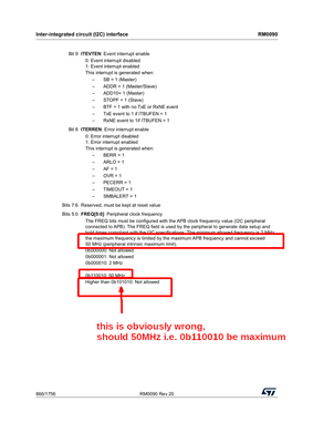

Is the maximum APB frequency setting 36MHz or 50MHz? See the dm00031020, page 863. FREQ[5:0]: Peripheral clock frequency..."Higher than 0b100100: Not allowed"
0b100100 corresponds to 36MHz, not 50MHz. Hopefully this is just a document error. We are using APB1 at 45MHz. Here is a link to the manual:
https://www.st.com/resource/en/reference_manual/dm00031020-stm32f405415-stm32f407417-stm32f427437-and-stm32f429439-advanced-armbased-32bit-mcus-stmicroelectronics.pdf
Is this a typo in the manual or is APB1 really limited to 36MHz for I2C?

Obviously a typo, relic probably from 'F1.

Thank you for bringing this to my attention. I will raise it internally to correct the RM0090.
The maximum frequency should be 45MHz with the overdrive for STM32F42x
In the RM0090: Higher than 0b100100: Not allowed
should be 0b101010:
“Bits 5:0 FREQ[5:0]: Peripheral clock frequency
Higher than 0b101010: Not allowed

Hello Imen,
sure that 0b101010 for FREQ[5:0] is correct?
It would mean 42 MHz, where 45 MHz would be 0b101101.
But according to RM0090 Rev 9 not allowed?

RM0090 is currently at rev.20.
Nonetheless, the said line should be fixed there:

An internal ticket ID 91710 is submitted in order to fix this issue.
