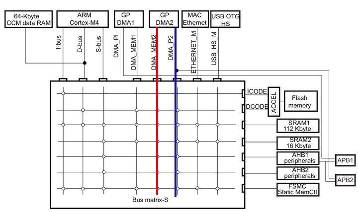

Hi I am using STM32F407ZET6 Microcontroller and I want to use multiple streams of DMA1. Is it possible to trigger two different streams of the same DMA for transferring data to two different peripherals simulatenously. (Like in Parallel).
In the advanced AHB bus matrix I observe that for each DMA there are only two lines, one for memory and one for peripheral, which suggest to me that at any time at max two streams can perhaps run in parallel and that also if none of the streams are really doing memory<->peripheral transfer. Is this assumption correct? And, is this also correct that to run two streams in parallel through a single DMA they should not be doing memory<->peripheral transfer? what I mean is that by the look of AHB matrix it felt if only Mem to Mem and Periph to Periph transfers are done then probably two streams can run in parallel, but if any one of them does memory<->peripheral transfer then the use of DMA memory and peripheral interface for a single transfer will probably make that NOT possible. Can you shed some light on this?
I would like to request some guidance on this particular topic as i could not find satisfactory information on it... And if it is dependent on the bus bandwidth to transfer streams in parallel then how the bandwidth is divided among multiple channels for a single bus to perform multiple transfer.... Some If there is any such example, i would be thankful. As a reference I have put the AHB matrix below:

‎2022-02-05 6:56 AM
I suppose one thing that makes me think multiple simultaneous paths in the bus matrix might be possible is the distinction between SRAM1 and SRAM2.
If only one of SRAM1 and SRAM2 may be accessed at a given time, then why specify that they are distinct?
Looking at the Reference Manual RM0090 Rev 15 p68/1745 I see in Section 2.3.1 Embedded SRAM:
The AHB masters support concurrent SRAM accesses (from the Ethernet or the USB OTG HS): for instance, the Ethernet MAC can read/write from/to SRAM2 while the CPU is reading/writing from/to SRAM1 or SRAM3.
(My bold)
(SRAM3 is only on stm32f42x / stm32f43x)
(But why explicitly Ethernet and USB; I know they have their own DMA controllers; are their ones privileged above DMA1 and DMA2?)
I suspect that there's only one access to the AHB matrix from e.g. DMA2, so any other concurrent transfer could not be on DMA2.
Hope this helps frame the next question,
Danish
‎2022-02-05 3:54 PM
Both are high-traffic interfaces, where large packets of data "appear suddenly" (after hardware finished checksum check, having them stored in their internal FIFOs). And, indeed their DMAs are capable of bursts, potentially blocking other users of given RAM for prolonged periods. That's why it's good to use a separate SRAM for their data, if there's any available.
No, there are two. Read my posts above, DMA chapter in RM0090 and AN4031.
‎2022-02-06 10:58 AM
Hi Jan,
What I meant was that I don’t expect DMA2 to be able to allocate e.g. Stream* 1 to one of those interfaces and Stream 2 to the other. If two streams are both ready to transfer, I expect DMA2 to apply priority/round-robin and do one after the other.
Whereas if DMA1 wants AHB and DMA2 also wants AHB, and their paths are independent then the AHB may allow both concurrently.
*or is it Channels on this stm32
Danish

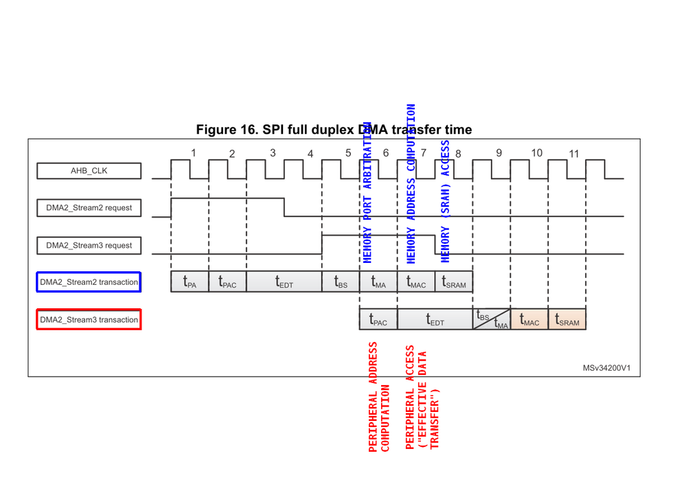

‎2022-02-06 2:57 PM
The two ports have separate arbitrators. Thus, if one stream transfers on memory port, the other can simultaneously transfer on peripheral port. This figure from AN4031 illustrates it:
Wherever dual-port DMA is used ('F2/'F4/'F7/"general purpose" DMA in 'H7) the transfer element is Stream. In the single-port DMA (all other STM32) it's Channel. Don't ask me...
