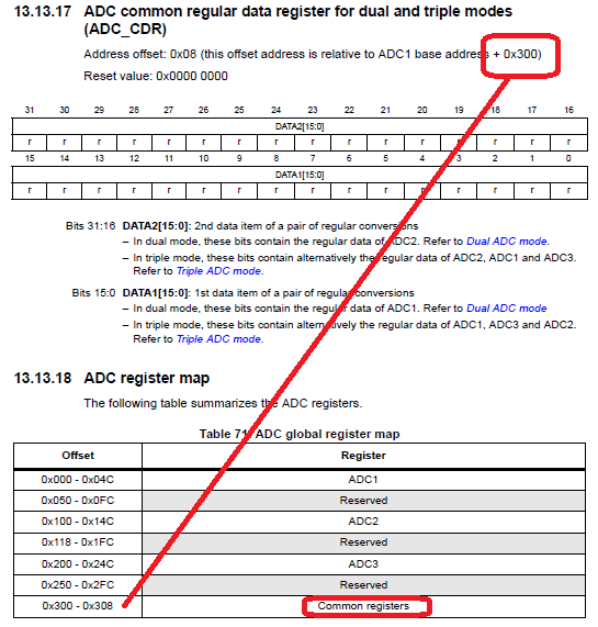

Talking specifically about the STM32F407xx series, I am now rather confused as to how the ADCx-DR setup works.
If you look at the , in Section 13.13.18, It indicates that there is:1 ADC->DR4 ADC->JDRx1 ADC->CDRWhich, to me, indicates that you can only actually pull from a single ADC->DR if you are using multiple ADCs that are converting at the same time.On the other hand, if you look at the , sm32f4xx_adc.c, and stm32f4xx.h, they seem to indicate that there are 3 different data registers.Which is it?- Mark as New
‎2014-01-09 1:58 PM
There is ONE ADCx->DR for each of the THREE ADC. Your may use these INDEPENDENTLY.
-- OR -- There is a COMMON area when you COMBINE TWO or THREE ADC in a DUAL and TRIPLE mode respectively.Up vote any posts that you find helpful, it shows what's working..
‎2014-01-09 2:07 PM
Ahh, Okay. This actually makes sense. I couldn't understand why they would design a system without independent data registers.
