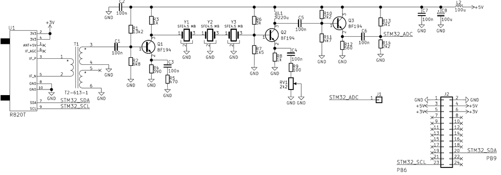

My goal is simple SDR receiver based on the R820T. I designed simple analog IF amplifier and I estimated calculation time in STM32F407. It should be possible to do that. Here comes IF schematic diagram:

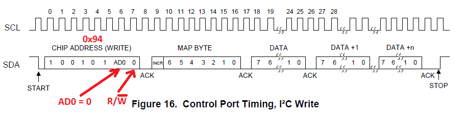

The datasheet address 0x94 from CS43L22's datasheet's is left shifted. It means that I have to use 0x94 with HAL drivers just like that:
#define DAC_I2C_ADDR 			0x94
static void write_register(uint8_t reg, uint8_t *data)
	iData[0] = reg;
	iData[1] = data[0];
	if (HAL_I2C_Master_Transmit(&i2cx, DAC_I2C_ADDR, iData, 2, 100) != HAL_OK)
		CS43_TIMEOUT_UserCallback();
Here comes write sequence from datasheet:
Bez tytułu.pngGenerally speaking it's one of the most strange hardware issues I've ever faced.
