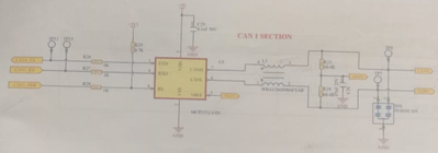

The image is not clear please share another one on which we can at least read the references.

Since it's a custom board, show us the schematic on how the CAN transceiver connection to the F405.
Also have you tried loop back mode?

I have not tried the loop back mode, i will try that as well.
I am not sure if the image is clear i will share the scanned image after some time.

You didn't show how the F407 is connected so don't know where the RS line of the transceiver is connected to? But i am going to take a guess that PORTC pin 1 or pin 3 controls the RS line?
Have you checked the TP13 with an oscilloscope to see if you're getting a CAN message? Maybe check the air core to be sure signals are on both High and low side to the transceiver.

RS pin of the transceiver connected to PortC pin 1 for can1 and PortC pin 3 is connected to can2 and I made them low using the program. The pins are pulled up by default. I will verify on scope the signals. But at present it is working due to wrong filter configuration, which I have taken from one of the websites.
