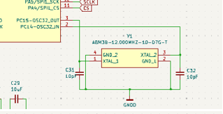

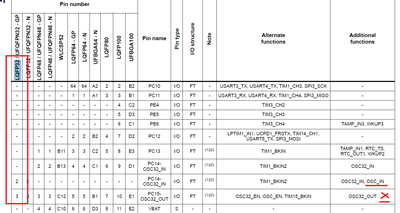

STM32G0B1KET6 CAN Bus-error
JSVENS3
Now I've been sitting here for 2 long day's and still haven't been able to solve the BUS-error problem.
I'm logging with Kvaser USB CAN card so what I want to see right now is some healthy frames coming out from it, but no, only bus-errors, so I thought it was time to ask the community about it.
I'm not a newbie in CAN and I've made an earlier project with STM32F302R8 which worked fine, but with this processor I seem to be stuck.
The main.c attached is only me trying to get the interfaces up and running.
What is strange is also the FDCAN Protocol status which doesn't seem to give me correct info, for example the "Activity status" which seems to be 8.
Are there a friendly soul somewhere that could help me out?
Intention is to get the classic CAN working and then Move over to CANFD. (With a different PC CAN interface of course)
Thank you in advance,
Johan
[FDCAN] Classic 125 kbit/s up (PCLK1=64000000 Hz)
[FDCAN] LEC=7, DLE=7, ACT=8, EP=0, Warn=0, BO=0, RxESI=0, RxBRS=0, RxFD=0, PE=0, TDC=0,
Clock check: SYSCLK=64000000 HCLK=64000000 PCLK1=64000000

  /* Try HSE crystal first (not BYPASS) */
  osc.OscillatorType      = RCC_OSCILLATORTYPE_HSE;
  osc.HSEState            = RCC_HSE_ON;       /* crystal */
  osc.PLL.PLLState        = RCC_PLL_ON;
  osc.PLL.PLLSource       = RCC_PLLSOURCE_HSE;/* 12 MHz */
  osc.PLL.PLLM            = RCC_PLLM_DIV3;    /* 12/3 = 4 MHz */
  osc.PLL.PLLN            = 32;               /* 4*32 = 128 MHz VCO */
  osc.PLL.PLLR            = RCC_PLLR_DIV2;    /* 128/2 = 64 MHz SYSCLK */
  osc.PLL.PLLQ            = RCC_PLLQ_DIV2;

Meanwhile, I'm not sure about this part from the schematics (it's a bit blurry):
Here you are using a crystal with 12M I think. But the part number you are using has only OSC_IN input for HSE. So you need to use a crystal oscillator (XO) and not a crystal (XTAL):
And you need to use an external crystal for CAN communication. What I suggest at this step is to check first the Clock frequency using MCO output and compare it to what you have set in CubeMx.
6 REPLIES 6
Not good! I missed that one, I will try to replace the XTAL with an XO instead.
