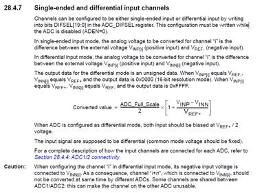

Need also to check if you're in differential / or single ended mode vs your HW:
PS: This is NOT an online support (https://ols.st.com) but a collaborative space. So please be polite in your reply. Otherwise, it will be reported as inappropriate and you will be permanently blacklisted from my help/support.
Its single ended mode.
