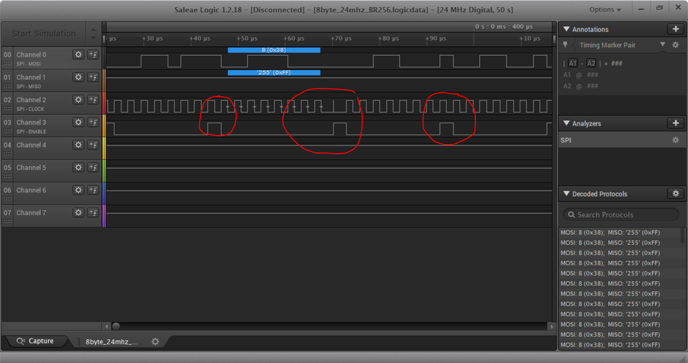

But when I pass multiple bytes( like 8, 25 etc) for last byte in the sequence is getting identified
 Please see below, Here data send are "12345678", but only 8 is identified(Data from 1-7 also present in transfer but during the ChipSelect high clock is present)
another example if "ABCDEFGH" is send means H will be identified.
Note: HAL_GPIO_WritePin(SPIx_NSS_Port, SPIx_NSS_Pin, GPIO_PIN_SET); is called inside HAL_SPI_TxCpltCallback() and is fine.

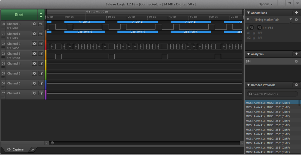

I pass
uint8_t aTxBuffer[] = "ABCDEFGH";
to this
void spi5_dataTransfer(uint8_t *TxBuffer)
  HAL_GPIO_WritePin(SPIx_NSS_Port, SPIx_NSS_Pin, GPIO_PIN_RESET);
  HAL_SPI_Transmit_DMA(&SPIx_handle, TxBuffer, 8u); //8u //1u
  while (HAL_SPI_GetState(&SPIx_handle) != HAL_SPI_STATE_READY);

Was the lower waveform (with red circles) taken with 8u or 1u?
And channel 3 displays the SPIx_NSS_Pin?

Lower waveform is taken with 8u.(Correct)
Channel 3 is NSS output.(Correct)
Issue is when the NSS is high, Clock also present. This is what I tried to showcase in image.
