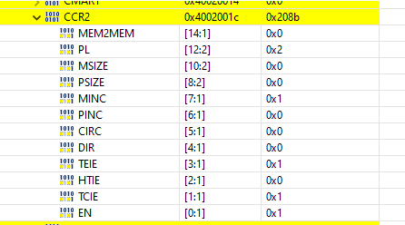

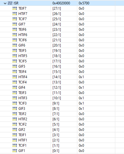

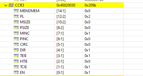

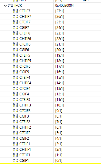

waclawek.jan
Polled SPI Rx works?
Read out and check/post content of SPI and DMA registers.
Dude
DMA1 -> ISR register
0693W00000WJ7Z1QAL.pngDMA1 -> IFCR register
DMA1 -> CCR2 Register
DMA1 -> CNDTR2 Register
0693W00000WJ7eYQAT.pngDMA1 -> CPAR2
DMA1 -> CMAR2
DMA1 -> CCR3

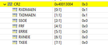

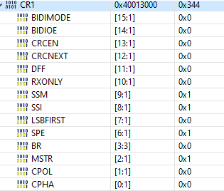

SPI Registers
SPI1 -> CR2
SPI1 -> SR
SPI1 -> DR

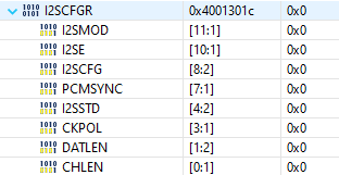

SPI1 -> I2SCFGR
SPI1 -> I2SPR

Noticed Behavior:
  1. Polling the SPI peripheral works (no DMA)
  2. The Tx transmission transfer complete interrupt triggers.
  3. The Rx receive complete interrupt never triggers.
  4. Manually polling the SPI_DR register returns the correct information (or so it appears)
So in short
  1. The DMA is sending
  2. The SPI is receiving
  3. The DMA doesn't seem to be handling receiving from the SPI properly.
Dude
Discovered the problem: TIM2_UP conflicting with SPI1_RX in DMA Channel 2. Didn't notice the conflict as it extended over to the backside of the printout.
waclawek.jan
Thanks for coming back with the solution. Please select your post as Best so that thread is marked as solved.
