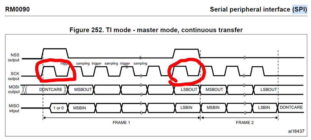

> Issue is when the NSS is high, Clock also present.
The "NSS" signal on the STM32F4 is not a CS signal. It pulses at the end of each byte in TI mode, which is presumably what you have selected. You'll need to use a different method.

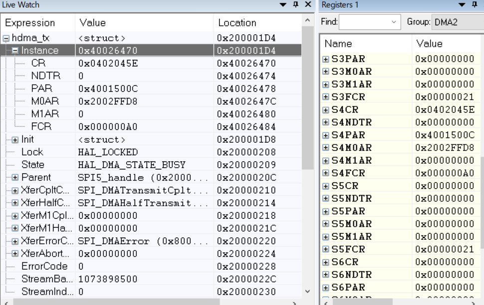

Ensure MX_DMA_Init is called before MX_SPI_Init.
If that's not it, show how you're using it or post the SPI and DMA register values.
Hi TDX,
Thanks for the response.
MX_DMA_Init is done before MX_SPI_Init
DMA2 Stream 4 and SPI5 is used.
please find the above images attached.
The DMA stream isn't enabled. Might be some flags set in DMA2_HISR.
Since NDTR=0, it could be that the transfer is complete, but you don't have the DMA transfer complete interrupt implemented or handled correctly, or interrupts are disabled.

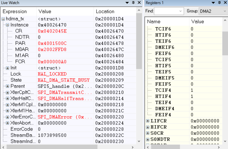

0693W00000GXj7qQAD.pngHi TDK,
DMA stream is Enabled and TC and HF bits in HISR are getting set after Transfer.
NDTR is getting populated during transfer.
Still then
_inline_ static void spi5_dataTransfer(uint16_t *TxBuffer)
  HAL_GPIO_WritePin(SPIx_NSS_Port, SPIx_NSS_Pin, GPIO_PIN_RESET);
  HAL_SPI_Transmit_DMA(&SPIx_handle, (uint8_t *)TxBuffer, 8u);
  HAL_GPIO_WritePin(SPIx_NSS_Port, SPIx_NSS_Pin, GPIO_PIN_SET);
  while (HAL_SPI_GetState(&SPIx_handle) != HAL_SPI_STATE_READY);
the control is not stopping at while(mentioned above).
And SPI state remains in "HAL_SPI_STATE_BUSY_TX" state.
Please help me to understand, what made you think "but you don't have the DMA transfer complete interrupt implemented or handled correctly, or interrupts are disabled".
Kindly reply, its helping me to understand more.

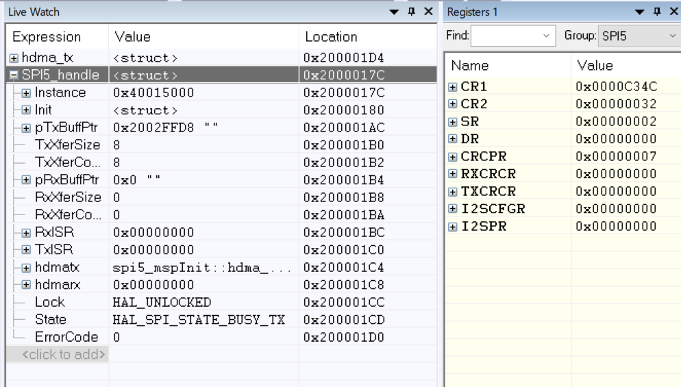

waclawek.jan
You appear to try to use SPI with CRC, is it intentional?
Do you use C++?
Since TCIE is set and TCIF is set, and the cpu isn't jumping into the handler, the corresponding NVIC enable bit isn't set, interrupts are disabled, or a higher priority interrupt is being ran.
Hi JW,
I use C language.
My SPI is configured without CRC (SPI_CRCCALCULATION_DISABLE)
Hi TDK,
The NVIC is enabled, I will check by modifying interrupt priority.
Sorry I misread the bits in SPI_CR1, indeed, you don't have CRCEN set (rather, BIDIMODE and BIDIOE).
