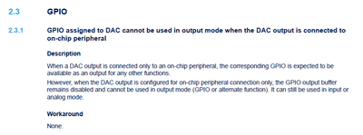

I’m currently testing on a Nucleo-G071RB and will eventually port everything to a custom board based on the STM32G071GBU3. As you suggested, I tried to bit-bang PA4—but while I could control other pins, PA4 wouldn’t toggle. Could this be related to the DAC?
I’m using DAC channel 1 as the COMP negative input.

waclawek.jan
Indeed, that will be it, as a consequence of the GPIO assigned to DAC cannot be used in output mode when the DAC output is connected to on-chip peripheral erratum.

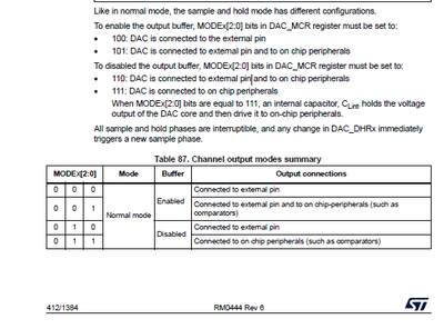

I rechecked the reference manual, and it states that setting the DAC_MCR MODE register to 0b011 disables the buffer and routes the DAC only to on-chip peripherals. I confirmed in the debugger that DAC1_CH1.MODE is indeed set to 0b011, so is it still impossible to use PA4 with other peripherals under these conditions?
waclawek.jan
Errata explain deviations from the reference manual (which describes the design intention), thus errata "override" the manual.
Have you read the quoted erratum?
I overlooked the note in the attached section. I’ll look into disabling the DAC during SPI transmissions. Thank you for your support.
