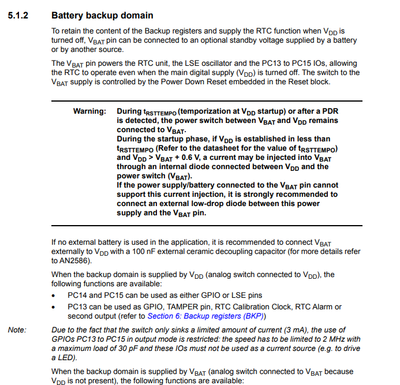

Hello @AbhijithKannan ,
Check that the LSE is correctly configured and stable. Did you follow the RM0008 in "Battery backup domain" section?

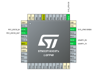

Did you initialize properly the GPIOs?

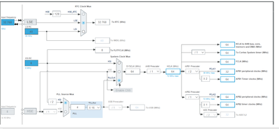

Hi @Imen.D
I believe I have configured the LSE correctly. I've attached screenshots of my CubeMX configurations for your review. Since I don't have a coin cell available, I'm currently supplying Vbat with 3.2V from another Nucleo board, while the ST Blue Pill is powered via the STLink V2 programmer.

Have you selected RTC output on tamper pin or RTC output disabled? Then select No RTC output. Please share the ioc.
October 16, 2024
I've attached the IOC file. The RTC is now working! I regenerated the code from CubeMX and haven’t made any changes since I last opened the project. I occasionally notice the RTC resetting, but I believe it's due to a loose jumper wire when I make adjustments to the board. Most of the time, the RTC functions correctly.
