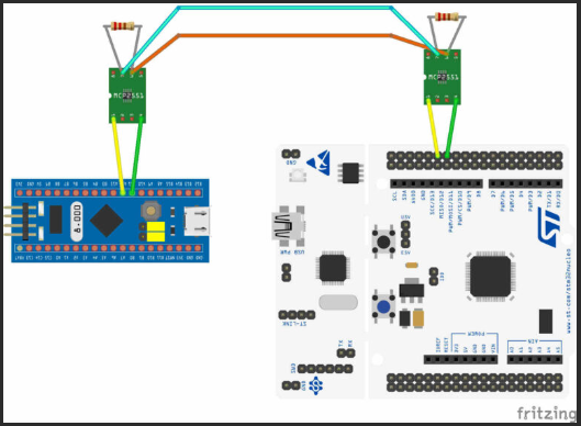

Does "Blue Pill" board embed CAN transceiver (I think not) ? If not, did you add this external component?
If not, it will never work!
@SofLit,
I think your statement is not correct: if on both side there is no tranceiver it can work for sure.
See "Beginning STM32, by Warren Gay ISBN978-1-4842-3623-9" P317 Chapter 18 CAN-bus"
RX and TX are connected to the same bus with a 4.7K pull up resistor.

We do NOT support this kind of "exotic" connections and we don't guarantee the behavior during the communication .. So, in normal mode, CAN bus SHOULD be used with transceivers in a complete bus configuration.
Hello, thank you for your comment.
I'm not using the USB, I have the st-link v2 programmer but I don´t use the USB.
Yes I´m using two transceivers with a 120 OHM resistance between CANH and CANL.
0693W00000UnkUjQAJ.pngI have a configuration like in the image but with both BluePills and the transceiver model is a TJA1050.

What is the voltage level of "S" pin (Silent mode)?
In the TJA1050 datasheet it was stated the following:
"Control pin S allows two operating modes to be selected: high-speed mode or silent mode....
In the silent mode, the transmitter is disabled. All other IC functions continue to operate. The silent mode is selected by connecting pin S to VCC and can be used to prevent network communication from being blocked, due to a CAN controller which is out of control."

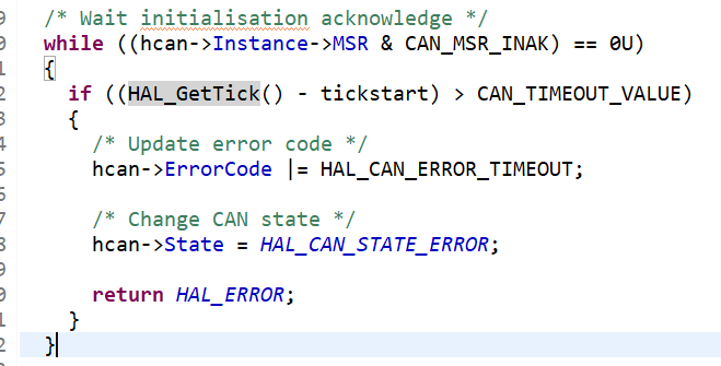

I´ve been trying to see what´s going on and its a HAL_Error.
When I init the can it enters here:0693W00000Uo62wQAB.pngAnd the HAL_GetTick () sets to -128 and there is the problem.
But i dont know why.
