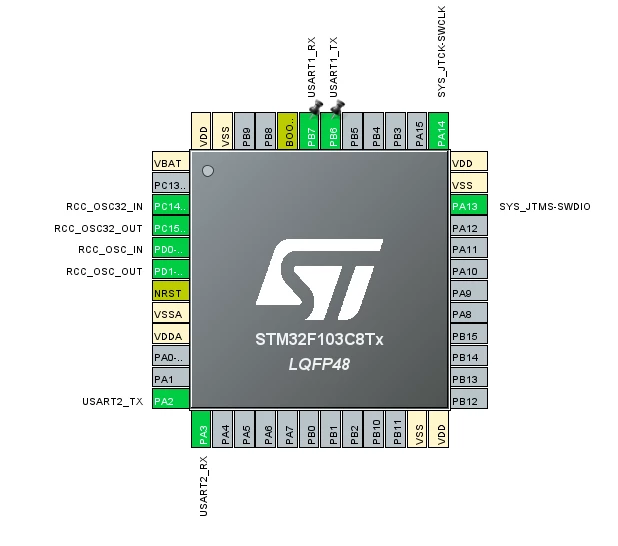

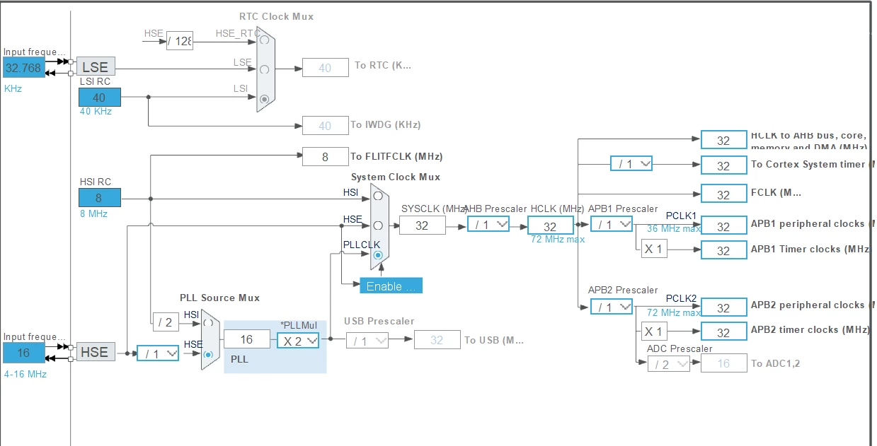

Greeting Everyone,
I am facing an issue with my STM32 board having STM32F103C8T6 as MCU, while trying to see a normal "Hello World" output. After debugging the board, I attempted to connect it to my PC via the serial port. To ensure proper communication, I installed the necessary Virtual COM Port drivers from the STM32 website.
However, my PC is not detecting the COM port to which the STM32 board is connected. Additionally, when I try to view the output on the Debugger Console within STM32CubeIDE, I encounter an error that prevents me from seeing the expected output.
I have written the code below that I'm using to print the Hello World which I have found online. Also I do not know if their is any problem on the code. With this I have also attached the Pin Configuration and Clock configuration details below as images.

void SystemClock_Config(void)
RCC_OscInitStruct.OscillatorType = RCC_OSCILLATORTYPE_HSE;
RCC_OscInitStruct.HSEState = RCC_HSE_ON;
RCC_OscInitStruct.HSEPredivValue = RCC_HSE_PREDIV_DIV1;
RCC_OscInitStruct.PLL.PLLSource = RCC_PLLSOURCE_HSE;
RCC_OscInitStruct.PLL.PLLMUL = RCC_PLL_MUL2;
Error_Handler();
RCC_ClkInitStruct.APB1CLKDivider = RCC_HCLK_DIV1;
RCC_ClkInitStruct.APB2CLKDivider = RCC_HCLK_DIV1;
if (HAL_RCC_ClockConfig(&RCC_ClkInitStruct, FLASH_LATENCY_1) != HAL_OK)

Could you please assist me in resolving this issue? I would appreciate any guidance or troubleshooting steps you can provide to help me get the serial communication working and view the output correctly.
Thank you for your support!

You did the printf retarget to the ITM not to the serial port.
ITM_SendChar((*ptr++));
Look at this example for STM32CubeF1 package:
https://github.com/STMicroelectronics/STM32CubeF1/tree/master/Projects/STM32F103RB-Nucleo/Examples/UART/UART_Printf
Look also at this thread: https://community.st.com/t5/stm32cubemx-mcus/how-to-retarget-printf-on-uart/td-p/380053

Tesla DeLorean
Guru
Apr 5, 2025 2:10 PM UTC
The ITM would come out of PB3 SWO via the SWV Viewer in STM32 Cube Programmer or your debugger.
The standalone ST-LINK/V2 doesn't provide a USART via a VCP
For your F103 to provide a VCP you'd need to compile as a USB VCP Device and communicate with that and not the USART, but wouldn't really allow for the type of blocking in-line interaction you're attempting.
Consider a cheap USB to CMOS Serial dongle for USART comms
