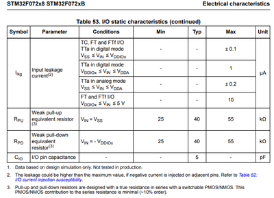

I want to know the Bus capacitance and Rise time of STM32F072V8T6 for I2C Calculation, Anyone who has know kindly tell me. Thank you.

IO pin capacitance will be in the chip's Datasheet - under electrical characteristics:

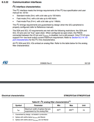

The following pages give further AC characteristics

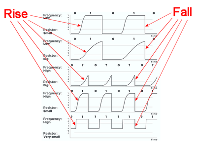

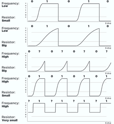

See this post:
https://electronics.stackexchange.com/questions/1849/is-there-a-correct-resistance-value-for-i2c-pull-up-resistors/473799#473799
It contains this diagram - which shows you the effect of the pullup value:

                  Would you inform me of the Hold time of SDA? I want to configure with LT8491 IC of which hole time is at least 300 ns needed.
The hold time should be at least half a clock cycle (after a rising edge of I2C SCK I2C SDA remains stable: SDA can only change when SCK is low...).
The bits on SDA changes when SCK is low and should be stable for at least half-a-clock period of SCK (to the next falling edge, if SCK is high: SDA should never change: except for START and STOP).
Hold Time is not really so important (it should be guaranteed by I2C device in MCU, it is hold for a half-clock cycle): a "Setup time" could be more interesting (how long before an SCK edge is SDA already stable).

When you say "Raise Time" which sounds to me as: "how fast are the signals (both: SCK and SDA) going back from low to high - this is only a function of you pull-up vs. the number of I2C slaves ("capacitors", plus cable). There is nothing on MCU which could control/set the "Raise Time"!
"Rise Time" means specifically the time it takes the bus to rise from the low level to the high level.
This is controlled by the pullups - not the drivers.
"Fall Time", conversely, means the time it takes the bus to fall from the high level to the low level.
This is controlled by the drivers.

Nothing to add: also very clearly to see the effect of a pull-up (raise time) vs. Open Drain sink for fall time.
A very great picture! (explaining the importance to have the right pull-up values).
