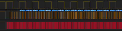

so I generate this simple test data with bitbang going into F401, content should be: 0001 0203, 0405 0607, 0809 0A0B  (only last is displayed)
zoomed out:
what I read in F401 is:
It starts to receive from second frame, that's fine, but why is the rest gibberish if data seems right?
Weird part is that during every test I get the same invalid values, like if it desyncronises everytime the same way.

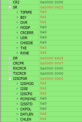

After receiving this is the SPI2/I2S register status
Not sure why the overrun error, since I do polling mode, and BCLK is slow bitbanged 19Khz.

On a 2nd MCU I bitbanged a valid I2S stream, that's what you can see on first 2 images, with slow BCK, and known data pattern.
Why would it read part of it correctly then rest as nonsense?
WS frame: 1empty clock, then 32clock for data,
data on rising clock.
