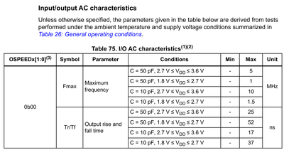

How to set GPIO output speed register (slow, medium, fast, very fast) in accordance to SPI and the slower I2C, clock speeds respectively?   The data sheet specify in rise/fall time. Is it correct that the register actually set drive current?
SPI clock at 6MHz is 83ns high and 83ns low.  Should we aim to make rise/fall time a "certain percentage" of 83ns?  If so, how much?
Part is STM32WLE5JCI6TR,
SPI bus has two external devices. Pin capacitance is about 5pF per device, presumably the MCU alos count as one, plus 5pF for PCB. That will be 20pF.  When putting a scope X10 passive probe will add 15pF.  Total 35pF. Still under the 50pF on data sheet. SPI clock about 6MHz.
I2C has one external device. Clock is 100 to 400kHz.

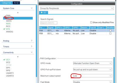

You can set them in the GPIO tab in CubeMX.
Edges can't be tuned that well. You only have 4 settings. You should set it so that it meets the requirement, but not any higher. Use the datasheet to pick the speed which meets requirements. For 8 MHz, it's probably medium. For I2C speeds, it's almost certainly low. Using a higher speed typically isn't a problem, but it will introduce more noise in the system.

AN4899 states SPI signal pin has schmitt trigger.  Presumably, a slower rise/fall signal will be read ok, without generating a lot of high and low when signal is passing slowly at threshold level.  Right?
Yes, the signal will be read correctly with any of those speeds as long as you're not exceeding the max frequency. The schmitt trigger has hysteresis. At any digital gpio speed setting, it's only going to flip state once per edge.
