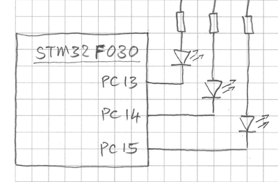

STM32F030 PC13,14,15 current sink limits?
Andrew Neil
Is it OK to use these pins as current sinks for driving LEDs ?

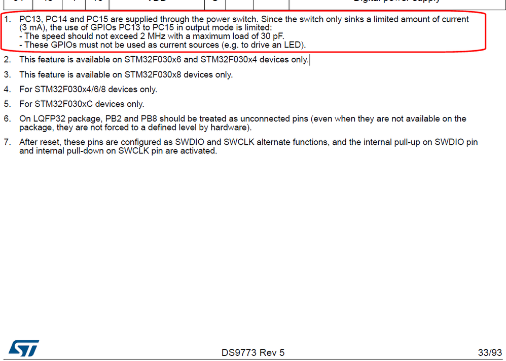

@STTwo-32,
> Thanks - it would be helpful if that could be clarified in the datasheet.
+1  (and I'd spell it "datasheets").
