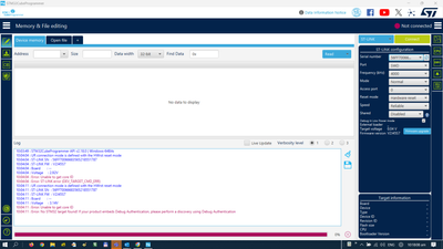

Is it correct that the flashing of STM32C071CB is not quite readily available?  I am using the newest stm32cubeprog, version 2.18.0, or Keil MDK version 5.41.
In both cases, I have tried to make a connection to the captioned MCU but I got failure in connection.
In particular, in MDK 5.41, I get this screen shot:
That the flashing driver of STM32C0x_64 is not the appropriate driver to being used for the 128K part.   I did look into the corresponding file folder, and I did locate STM32C0x_128.FLM file but some how I cannot get this in the file list for the selection.
Anyone out there experienced similar issue, and any remedy to the problem.
By the way, I did tried to use 3 different PCBA  boards in no vain, but replacing the MCU with stm32c031c6 on one of the PCBA did get connection done seamlessly though.

The problem is not clear. For example, what is the exact problem with CubeProgrammer? what error are you facing?

Hi SofLit
Regarding stm32cubeprog v2.18.0, the connection could not established.
For Keil 5.41, even though I selected the correct part of STM32C071CB, the 128K flash part, Keil just give me the  flashing driver of STM32C0x_64, which is not the appropriate driver to being used for the 128K part.   I did look into the corresponding file folder, and I did locate STM32C0x_128.FLM file but some how I cannot get this in the file list for the selection.
If you look into the initial screen capture of Keil flash download page, you can see the ROM address space did give 128K flash selection (08000000H - 0801FFFFH) though.
Having said that, I cannot get Keil into debug mode, and is experiencing the same failure to make connection issue.
Of course, there is also a chance of getting unlucky batch of faulty MCUs though.
I am using stlink v2, its details was shown in the stm32cubeprog screenshot.

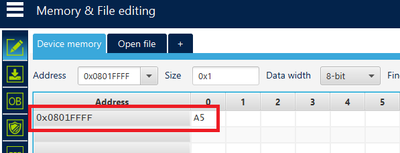

Hello @Chan.Calvin ,
For CubeProgrammer I didn't reproduce the behavior with a NUCLEO-C71RB. C71RB and C71CB are same from Flash point of view. So you need to check your HW.
This is a screen shot of my connection with CubeProgrammer to an STM32C71RB. I've written 0xA5 to the last location of 128KB:

@Chan.Calvin wrote:
Your image is too low resolution to read.
Please select all the log text, and post here as text.

Hi all
Attached is the cubeprog and stlink screenshot for your ref.
I believed it is the genuine stlink v2.  And we are using custom board.
As mentioned before, with the C071CB on custom board, it is failed to flash.
Replacing the C071CB with C031C6, the board becomes alive, and I can do flashing and Keil debugging.
Another blank PCB, with just only another new C071CB put on, that also failed to flash.
That points to me that it is either the batch of faulty MCU, or missing update driver to handle xB - 128K parts.
Anyway, we are making some other different PCBA with the STM32C071GB from other supplier, so I think I need to wait for this batch to see if that goes well.
