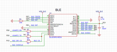

I’m porting the DATALOG2 application from
fp-sns-datalog2\STM32CubeFunctionPack_DATALOG2_V3.1.0\Projects\STM32U585AI-STWIN.box\Applications\DATALOG2to the STM32U575VGT6, but I’m running into issues with the Bluetooth functionality during debugging. Does anyone have any suggestions?
The code enters this section:
if (ret_status != (ble_status_t)BLE_STATUS_SUCCESS)
BLE_MANAGER_PRINTF("Error: HCI_LE_SET_SCAN_RESPONSE_DATA [%x]\r\n", ret_status);
goto end_label;
I can erase, read, and program the BLUENRG-M2SA using RF-Flasher Utility v4.5.0, which indicates that the chip is not damaged.
The complete project source code is attached.
The hardware circuit is as follows:
The code is as follows:

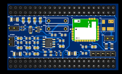

dzf
my PCB layout is as following, does it led to the above question?

This error usually means the BLE stack isn’t fully initialized or the HCI transport isn’t ready when HCI_LE_SET_SCAN_RESPONSE_DATA() is called.
Things to check first:
  • Make sure BLE_Init() / hci_init() has completed successfully before calling set_connectable_ble().
  • Verify the SPI/UART pins, CS, RESET, and IRQ for the BLUENRG-M2SA match the STWIN.box reference design (IRQ miswiring is a common cause).
  • Confirm the correct BLUE_CORE define is used for BLUENRG-M2SA and that the matching middleware version is enabled.
  • Ensure the BLUENRG firmware version is compatible with the DATALOG2 middleware you’re using.
Since RF-Flasher works, the chip is fine — this is almost always a host–BLE interface or init sequence issue, not hardware damage.
