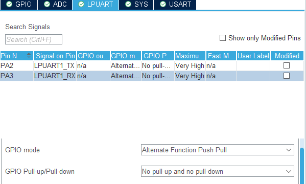

Thanks @KnarfB and @Community member for your valuable comments.
Should i use the pull up setting that comes with the UART configuration itself (As mentioned in the image below) or should if configure the pin as input with a internal pull up before UART initialization.
