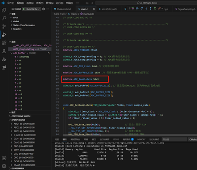

I wonder why I have data in the buffer when my sample rate is 30KHz and 0 when the sample rate is 50KHz.
My code:

#define ADC1_TRIGGER htim3
uint8_t ADC1_CompleteFlag = 0; // ADC1转换完成标志位
uint8_t ADC2_CompleteFlag = 0; // ADC2转换完成标志位
#define ADC_TIM_Clock 84e6 // 定时器时钟频率
#define ADC_BUFFER_SIZE 1024  // 假设采2048组数据(FFT一般要2的幂次)
#define ADC_SampleRate 30e3
uint32_t adc_buffer[ADC_BUFFER_SIZE]; // 注意是uint32_t,因为双ADC打包成32位
uint16_t adc_buffer1[ADC_BUFFER_SIZE];
uint16_t adc_buffer2[ADC_BUFFER_SIZE];
void ADC_SetSampleRate(TIM_HandleTypeDef *htim, float sample_rate)
    uint32_t Timer_Clock = ADC_TIM_Clock / (htim->Instance->PSC + 1);
    uint32_t timer_reload_value = (uint32_t)(Timer_Clock / sample_rate) - 1;
    if (timer_reload_value < 1) timer_reload_value = 1;
    HAL_TIM_Base_Stop(htim);                   // 安全:暂停 TIM
    __HAL_TIM_SET_AUTORELOAD(htim, timer_reload_value);
    __HAL_TIM_SET_COUNTER(htim, 0);            // 重置计数器
    HAL_TIM_Base_Start(htim);                  // 重新启动 TIM
    USART_Printf(&huart1, "ADC TimerClock=%lu, ARR=%lu, SampleRate=%.1f Hz\r\n",
                 Timer_Clock, timer_reload_value, sample_rate);

//   ADC TimerClock=84000000, ARR=8399, SampleRate=10000.0 Hz
// ADC TimerClock=84000000, ARR=2099, SampleRate=40000.0 Hz
// ADC TimerClock=84000000, ARR=1679, SampleRate=50000.0 Hz
// 为什么采样率设置为50K时,主循环没有打印串口数据,DMA是normal模式,排除串口速度跟不上

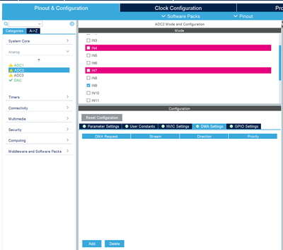

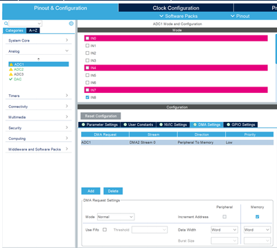

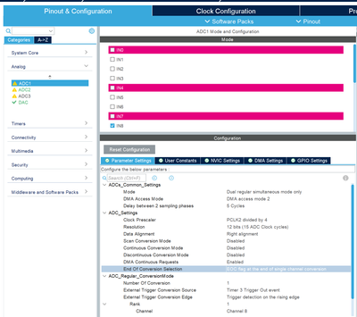

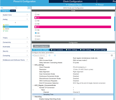

ADC:
/* USER CODE BEGIN Header */
  * @file    adc.c
  * @brief   This file provides code for the configuration
  *          of the ADC instances.
  * @attention
  * Copyright (c) 2025 STMicroelectronics.
  * All rights reserved.
/* USER CODE END Header */
#include "adc.h"
/* USER CODE BEGIN 0 */
/* USER CODE END 0 */
ADC_HandleTypeDef hadc1;
ADC_HandleTypeDef hadc2;
DMA_HandleTypeDef hdma_adc1;
/* ADC1 init function */
void MX_ADC1_Init(void)
  /* USER CODE BEGIN ADC1_Init 0 */
  /* USER CODE END ADC1_Init 0 */
  ADC_MultiModeTypeDef multimode = {0};
  ADC_ChannelConfTypeDef sConfig = {0};
  /* USER CODE BEGIN ADC1_Init 1 */
  /* USER CODE END ADC1_Init 1 */
  /** Configure the global features of the ADC (Clock, Resolution, Data Alignment and number of conversion)
  hadc1.Instance = ADC1;
  hadc1.Init.ClockPrescaler = ADC_CLOCK_SYNC_PCLK_DIV4;
  hadc1.Init.Resolution = ADC_RESOLUTION_12B;
  hadc1.Init.ScanConvMode = DISABLE;
  hadc1.Init.ContinuousConvMode = DISABLE;
  hadc1.Init.DiscontinuousConvMode = DISABLE;
  hadc1.Init.ExternalTrigConvEdge = ADC_EXTERNALTRIGCONVEDGE_RISING;
  hadc1.Init.ExternalTrigConv = ADC_EXTERNALTRIGCONV_T3_TRGO;
  hadc1.Init.DataAlign = ADC_DATAALIGN_RIGHT;
  hadc1.Init.NbrOfConversion = 1;
  hadc1.Init.DMAContinuousRequests = ENABLE;
  hadc1.Init.EOCSelection = ADC_EOC_SINGLE_CONV;
  if (HAL_ADC_Init(&hadc1) != HAL_OK)
    Error_Handler();
  /** Configure the ADC multi-mode
  multimode.Mode = ADC_DUALMODE_REGSIMULT;
  multimode.DMAAccessMode = ADC_DMAACCESSMODE_2;
  multimode.TwoSamplingDelay = ADC_TWOSAMPLINGDELAY_5CYCLES;
  if (HAL_ADCEx_MultiModeConfigChannel(&hadc1, &multimode) != HAL_OK)
    Error_Handler();
  /** Configure for the selected ADC regular channel its corresponding rank in the sequencer and its sample time.
  sConfig.Channel = ADC_CHANNEL_8;
  sConfig.Rank = 1;
  sConfig.SamplingTime = ADC_SAMPLETIME_15CYCLES;
  if (HAL_ADC_ConfigChannel(&hadc1, &sConfig) != HAL_OK)
    Error_Handler();
  /* USER CODE BEGIN ADC1_Init 2 */
  /* USER CODE END ADC1_Init 2 */
/* ADC2 init function */
void MX_ADC2_Init(void)
  /* USER CODE BEGIN ADC2_Init 0 */
  /* USER CODE END ADC2_Init 0 */
  /* USER CODE BEGIN ADC2_Init 1 */
  /* USER CODE END ADC2_Init 1 */
  hadc2.Instance = ADC2;
  hadc2.Init.ClockPrescaler = ADC_CLOCK_SYNC_PCLK_DIV4;
  hadc2.Init.Resolution = ADC_RESOLUTION_12B;
  hadc2.Init.ScanConvMode = DISABLE;
  hadc2.Init.ContinuousConvMode = DISABLE;
  hadc2.Init.DiscontinuousConvMode = DISABLE;
  hadc2.Init.DataAlign = ADC_DATAALIGN_RIGHT;
  hadc2.Init.NbrOfConversion = 1;
  hadc2.Init.DMAContinuousRequests = DISABLE;
  hadc2.Init.EOCSelection = ADC_EOC_SINGLE_CONV;
  if (HAL_ADC_Init(&hadc2) != HAL_OK)
    Error_Handler();

KnarfB
For small Timer_Clock  and high sample_rate, (uint32_t)(Timer_Clock / sample_rate) will be zero. Subtracting 1 yields an overflow because of unsigned, which results in a huge number. This may effectively stop your ADC capture.
hth
KnarfB
