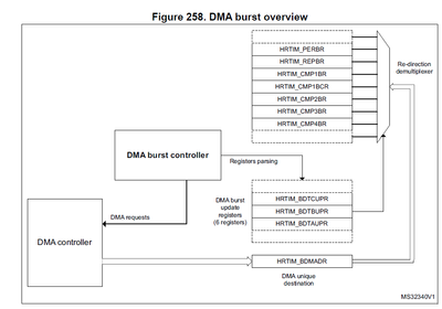

Hi all,
I am trying to configure burst dma on my board (stm32g474). I have successfully configure the dma for single register, however, when I want to configure dma for more than one register, I failed to do that as it only allow me to fill one address for DMA Src address when 2 channels should be updated. Do anyone know how should I configure the DMA Src address if I want to use dma to update 2 respective dma channel?

Pierre_Paris
Hello @OFNand @FBL,
Let me share with you some additional information!
Here the Figure 258. from RM0440 on HRTIM chapter (especially 27.3.23).
On the overview below, there are 3 types of registers :
  • HRTIM_BDMADR (Burst DMA data register) : DMA unique destination (burst operation is started by the first write access in this register)
  • Registers to update for your application (eg : HRTIM_PERBR, HRTIM_CMP1BR....)
  • 6 update registers multiplexing HRTIM_BDMADR  to the register you want to update. (HRTIM handles internally the data re-routing to the final destination register).
It is only necessary to have the DMA controller pointing to the HRTIM_BDMADR register as
the destination, in the memory, to the peripheral configuration with the peripheral increment
mode disabled.
Once you write in HRTIM_BDMADR, it's automatically triggers (no need Burst DMA source):
  • The copy of the data value into the registers enabled in BDTxUPR and BDMUPR register
    bits
  • The increment of the register pointer to the next location to be filled
