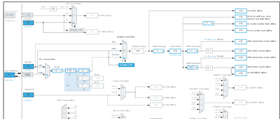

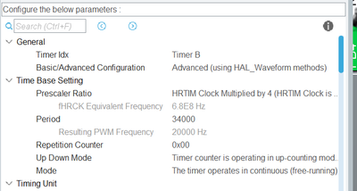

tima 的pwm输出正确,但是timb的pwm一个周期出现无法reset的情况

Hello @xcm
Please try to write in English to make sure you can get an answer, because most of the people on this community can speak English but not Chinois.
If possible, to provide more details on your issue and share your code, TIM configuration, software version used.
Did you check the known HRTIM limitations in the STM32G471xx/473xx/474xx/483xx/484xx device errata - Errata sheet?

ok,
void HAL_HRTIM_RepetitionEventCallback(HRTIM_HandleTypeDef *hhrtim, uint32_t TimerIdx)//20kHz中断
if (TimerIdx == HRTIM_TIMERINDEX_TIMER_A)
HAL_HRTIM_WaveformOutputStart(&hhrtim1,HRTIM_OUTPUT_TA1 | HRTIM_OUTPUT_TA2 | HRTIM_OUTPUT_TB1 | HRTIM_OUTPUT_TB2 | HRTIM_OUTPUT_TC1 | HRTIM_OUTPUT_TC2);
//HAL_HRTIM_WaveformOutputStart(&hhrtim1,HRTIM_OUTPUT_TB1 | HRTIM_OUTPUT_TB2);
hhrtim1.Instance->sTimerxRegs[0].CMP1xR = SPWM_400[i];
hhrtim1.Instance->sTimerxRegs[0].CMP3xR =SPWM_400[399-i];
hhrtim1.Instance->sTimerxRegs[1].CMP1xR = SPWM_400[i];
hhrtim1.Instance->sTimerxRegs[1].CMP3xR = SPWM_400[399-i];
The two PWM is not the same as the picture shows.how to solve it.every period has a wrong pwm(50Hz).TA1(the red one) is correct while the TB1(the yellow one) is not the same as i set.

July 3, 2025
What about CKPSC? Make sure to adjust the clock prescaler and timing parameters to ensure cycle accuracy.
xcmAuthor
July 3, 2025
which one?what can I do ?
