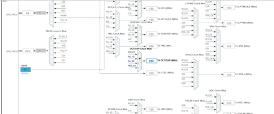

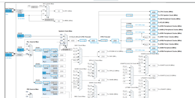

Starting from a working application based on the STM32U585A microcontroller, we changed the CPU to have the ETHERNET peripheral available. The flash is connected via quadSPI to the microcontroller, while the RAM is connected via octospi .
Microcontroller Model: STM32H723ZGT6 FLASH MODEL: S25FL064L DRAM MODEL: APS6408L
Regarding the configuration operations of both the flash and the RAM, everything seems to work, but when it comes to reading or writing, we receive incorrect data once out of 10 attempts. Note that we have a working application with the STM32U5 microcontroller using the same flash and RAM.
Any idea on what I’m I missing?

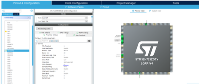

Flash initializzation
void MX_OCTOSPI2_Init(void)
  /* USER CODE BEGIN OCTOSPI2_Init 0 */
  /* USER CODE END OCTOSPI2_Init 0 */
  OSPIM_CfgTypeDef sOspiManagerCfg = {0};
  /* USER CODE BEGIN OCTOSPI2_Init 1 */
  /* USER CODE END OCTOSPI2_Init 1 */
  hospi2.Instance = OCTOSPI2;
  hospi2.Init.FifoThreshold = 1;
  hospi2.Init.DualQuad = HAL_OSPI_DUALQUAD_DISABLE;
  hospi2.Init.MemoryType = HAL_OSPI_MEMTYPE_MICRON;
  hospi2.Init.DeviceSize = 23;
  hospi2.Init.ChipSelectHighTime = 1;
  hospi2.Init.FreeRunningClock = HAL_OSPI_FREERUNCLK_DISABLE;
  hospi2.Init.ClockMode = HAL_OSPI_CLOCK_MODE_0;
  hospi2.Init.WrapSize = HAL_OSPI_WRAP_NOT_SUPPORTED;
  hospi2.Init.ClockPrescaler = 4;
  hospi2.Init.SampleShifting = HAL_OSPI_SAMPLE_SHIFTING_NONE;
  hospi2.Init.DelayHoldQuarterCycle = HAL_OSPI_DHQC_DISABLE;
  hospi2.Init.ChipSelectBoundary = 0;
  hospi2.Init.DelayBlockBypass = HAL_OSPI_DELAY_BLOCK_BYPASSED;
  hospi2.Init.MaxTran = 0;
  hospi2.Init.Refresh = 0;
  if (HAL_OSPI_Init(&hospi2) != HAL_OK)
    Error_Handler();
  sOspiManagerCfg.ClkPort = 2;
  sOspiManagerCfg.NCSPort = 2;
  sOspiManagerCfg.IOLowPort = HAL_OSPIM_IOPORT_2_LOW;
  if (HAL_OSPIM_Config(&hospi2, &sOspiManagerCfg, HAL_OSPI_TIMEOUT_DEFAULT_VALUE) != HAL_OK)
    Error_Handler();
  /* USER CODE BEGIN OCTOSPI2_Init 2 */
  /* USER CODE END OCTOSPI2_Init 2 */

Hello @franckngatcha
Did you set the same clock config for OCTOSPI as U5 ?
Saket_Om
franckngatcha
Hi sacket_Om,
we'd configure the flash and the ram to run at 50MHZ
i've tried to reduce that speed without result.
Franck
Please try to use the same OCTOSPI initialization setting as in U5 examples.
Saket_Om
