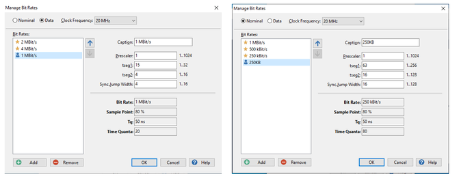

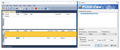

‎2024-08-26 7:26 AM
I received my custom board with the same MCU, but it has a 208-pin package. However, when I tried to communicate with the bootloader, it didn't respond.
- Used pins are : PH13 / PH14.
- USED Baudrate :
I've tried testing different methods to communicate with the bootloader, but none have worked so far.
Could you please help me with using this bootloader?

‎2024-08-27 9:52 AM
The setup seems OK (Baudrates are OK) to get the Bootloader to answer You have to send one of the commands in AN5405.
