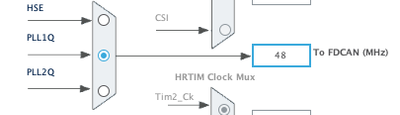

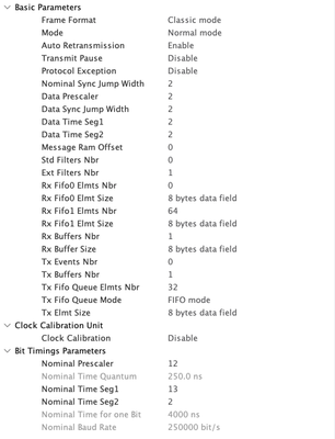

I am implementing an interface between an STM32H750 and a CanBus device of an electric bike. I have the FDCAN peripheral configured to 250kbit/s (FDCAN clock is 48MHz)
I have to interface with devices that use Extended Frames, but the speed is fixed to 250bit/s, so I wanted to use normal mode.

What frame format your CAN bus needs to support classic or FD?
I see in your code:
CAN_TxHeader.FDFormat = FDCAN_FD_CAN;
Are you sure it's FD?
You didn't share your CAN initialization code.
I suggest to share your project so we can check all the parameters and config.
Please remove all the stuff not related to the CAN. Keep only the minimal but a complete project that let others run a test.

Changing this:
Fixed the issue
