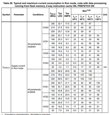

The reason I want to use the H5 range is the lower power usage, and the fact it has onboard flash.

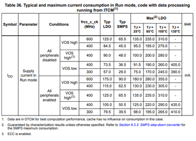

The issue with the STM32H7S and R series is that they use too much power and don't have onboard flash, and for the application I want, I'm after an energy efficient MCU with onboard flash, hexadeca support and USB HS. Unfortunately this is only available in the U5 range, but they aren't fast enough for the compute needed for my application, but the H5 is. Also, the H7S/R is overkill for my needs.

For sure the H7RS is not create for battery powered devices. H7R3 in VOS LOW with core freq at 300/400MHz, would still consume more than the H5 comparing all peripherals ON in Run mode. But we do see some applications where the MCU is not the main consumer of the battery. for example in Thermostats or Ebikes etc, which sometimes with on larger displays/resolutions.

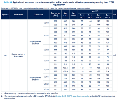

If you look for more DMIPS with a Cortex-M7, you could look at the STM32H7A3, its not a low power device but it brings some lower power capabilities compared to other high perf MCUs. On top you can connect up to 2x OctoSPI memories, so could also be 2xSerial 8bit RAMs at 100-140MHz, bringing more performance but also more complex memory/code partitioning.
