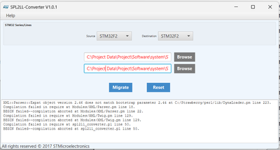

Dear all,
I am trying to convert the SPL to LL using the SPL2LL converter. After pressing the migrate button, I got the message below. Please help. Is it the problem that I chose the wrong directory? I chose the directory where the main.c file is located (./). All the others' ./apps are stored in /app.

and what platform you're running on, version, etc ...
:thinking_face:

Dear Andrew,
As I mentioned in the previous message, I am using Perl 5.24.4.1 and running on Windows11 platform.
no, you hadn't mentioned Windows 11.
