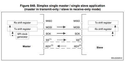

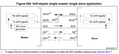

Do you want to use half-duplex to run a Half-Duplex communication or simplex communication?
In these cases,  the SS works as a standard ‘chip select’ input and lets the slave communicate with the master in slave mode. In Master mode, the SS can be used either as an output or an input.
In a configuration with two or more independent slaves, the master uses a star topology with dedicated GPIO pins to manage the chip select lines for each slave separately.

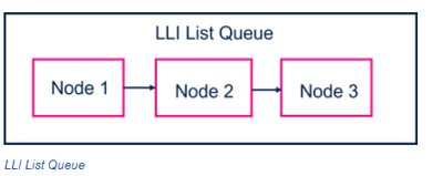

As mentioned in RM0456  section 17.4.5 GPDMA linked-list data structure "The direct programming mode, a channel can be programmed by a list of transfers, known as a list of linked-list items (LLI). Each LLI is defined by its data structure. " So, I didn't any limitation to one channel with a list of transfer.
So, if you used two nodes, the first node in the loop is where the LLR from the last node in the queue is pointed as mentioned in this FAQ "How to configure the linked list mode in STM32CubeMX".

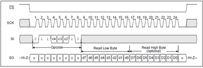

Rickou73Author
October 29, 2024
Hi @KDJEM.1
none of both ...
in fact it is a full duplex electrically,
but protocol is same as a SPI RAM/EEPROM
1st part of transaction, host send the wanted address, then 2nd part host read datas from device.
I thnink linked list can do the job, but in SPI init configuration there is 2 handlers for 2 DMA channels.. 1 for Tx, the other for Rx, so in this configuration, i can't use linked list..
and linked to that, which function should i call ?
i don't find this kind of example.
but this is the goal of this post, maybe it is not possible to do Tx, then Rx, using 1 DMA channel on SPI without code interaction during the full transaction..
For example, the octospi allow to do this.. only 1 DMA handler for both command Tx, then data Rx...
