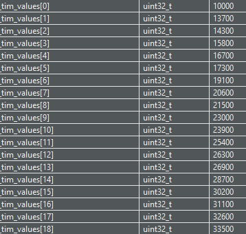

We try generate signal defined by toggle table , but command do nothink. (except ARR toggles)
   if (HAL_TIM_OC_Start_DMA(&htim2, TIM_CHANNEL_4, &tim_values[0], idx) != HAL_OK)
     Error_Handler();
have 1.7.0 U5 firmware some known issue ? Or what is required to right setup this.
We try add enable GPDMA etc. No change. For ARR is one toggle no based on table. Seems we skip some trigger setup or U5 HAL is buggy .? Pls help. Simply we have table and require toggle for example 20 words table in time.

If DMA would not work, you should see the output to toggle at the ARR rate anyway. So is that what is happening?
Read out and check/post content of TIM and DMA registers, perhaps at the moment when it already has been started but does not work as expected. Also, show us the array you are transferring using DMA.
Note, that if you want the "walking toggle" i.e. your array consists of values with small differences, all of them to be used within one ARR period, then you have to make sure the TIMx_CCRx is not preloaded, i.e. the respective TIMx_CCMRx.OCxPE has to be 0. I don't know how this is done in Cube, I don't use Cube.
Yes i write this ARR toggles = normal when CCR is constant in real toggles CCR. Yes debuger show all aka ok, but no real work. xPE is 0 DIER CC4DE is only 1 mode 0x3 and if manualy insert CC4=10000; before dma line one 10ms pulse is ok generated , but nothing next from DMA and repeat only ARR time...
waclawek.jan
So if TIM works as expected, the problem is probably at the DMA side.
The 'U5 GPDMA is very different from the older STM32 DMAs and I don't know it, but generally, looking at the DMA registers and checking them against expected values according to the reference manual should give a clue.
