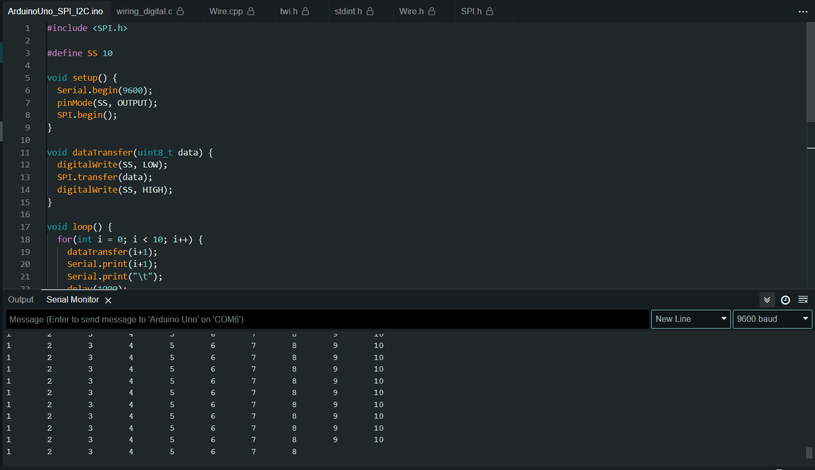

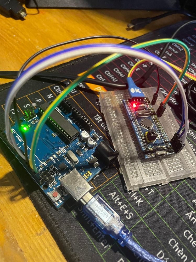

My problem is the SPI communication between the blue pill board STM32F103C8T6 (slave) and the Arduino Uno R3 board (master). Here is my setup:
1. For arduino:
The code:
#include <SPI.h>
#define SS 10
void setup() {
  Serial.begin(9600);
  pinMode(SS, OUTPUT);
  SPI.begin();
void dataTransfer(uint8_t data) {
  digitalWrite(SS, LOW);
  SPI.transfer(data);
  digitalWrite(SS, HIGH);
void loop() {
  for(int i = 0; i < 10; i++) {
    dataTransfer(i+1);
    Serial.print(i+1);
    Serial.print("\t");
    delay(1000);
  Serial.print("\n");

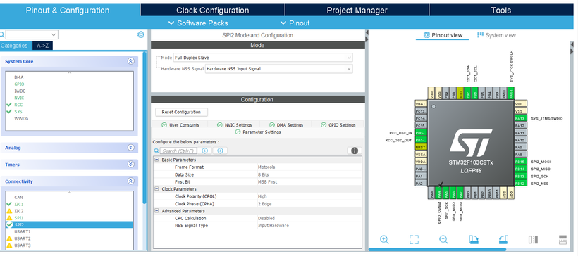

2. For STM32:
Here is my SPI2 configuration:
static void MX_SPI2_Init(void)
hspi2.Instance = SPI2;
hspi2.Init.Mode = SPI_MODE_SLAVE;
hspi2.Init.Direction = SPI_DIRECTION_2LINES;
hspi2.Init.DataSize = SPI_DATASIZE_8BIT;
hspi2.Init.CLKPolarity = SPI_POLARITY_HIGH;
hspi2.Init.CLKPhase = SPI_PHASE_2EDGE;
hspi2.Init.NSS = SPI_NSS_HARD_INPUT;
hspi2.Init.FirstBit = SPI_FIRSTBIT_MSB;
hspi2.Init.TIMode = SPI_TIMODE_DISABLE;
hspi2.Init.CRCCalculation = SPI_CRCCALCULATION_DISABLE;
hspi2.Init.CRCPolynomial = 10;
if (HAL_SPI_Init(&hspi2) != HAL_OK)
Error_Handler();
/* USER CODE BEGIN SPI2_Init 2 */
/* USER CODE END SPI2_Init 2 */

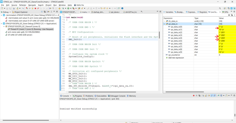

 my main.c of stm32:
int main(void)
HAL_Init();
SystemClock_Config();
MX_GPIO_Init();
MX_I2C1_Init();
MX_SPI1_Init();
MX_SPI2_Init();
HAL_SPI_Receive_IT(&hspi2, (uint8_t*)spi_data_rx,10);
while (1)
while(HAL_SPI_GetState(&hspi1)!=HAL_SPI_STATE_READY);
 I write a file naming spi_slave.c and spi_slave.h to handle incoming data using interrupt, this is the .c one and the .h is empty:
#include "main.h"
#include "spi_slave.h"
extern SPI_HandleTypeDef hspi2;
#define spi_rxsize 10
char spi_data_rx[spi_rxsize];
uint8_t spi_rxcount = 0;
int spi_countAddr = 0;
int spi_countrxcplt = 0;
int spi_counterror = 0;
void HAL_SPI_RxCpltCallback(SPI_HandleTypeDef *hspi)
if(hspi->Instance == SPI2)
HAL_SPI_Receive_IT(&hspi2, (uint8_t*)spi_data_rx, 10);
void HAL_SPI_ErrorCallback(SPI_HandleTypeDef *hspi) {
spi_counterror++;
 Though I send 10 numbers from Arduino, I still miss some numbers when my stm32 reads them

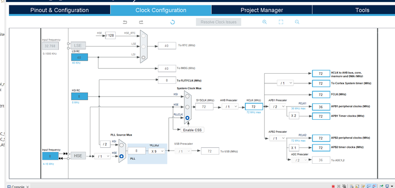

STM32 clock configuration:

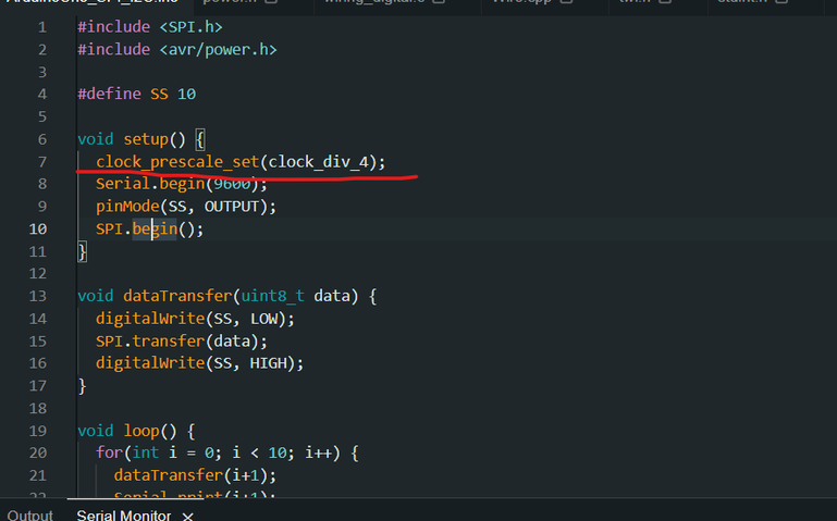

I tried lower the speed of Arduino clock about 2 or 4 times, but there is no use, the stm32 still misses the data.

Please ensure that the GND (ground) pin of the Arduino board is connected to the GND pin of the STM32 board.
Saket_Om
Thanks, but the hardware connect doesn't matter. I connect both SPI and I2C, the I2C works okay, but the SPI is very problematic :(((
