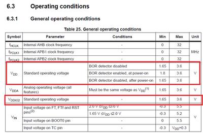

I am using STM32L071C8T6 which has a VDDIO2 power pin. I don't see any information on this pin in the STM32L0xx hardware dev reference. My application doesn't require a separate level or source for any GPIO's, so can I connect VDDIO2 directly to VDD?

According to the datasheet:
So yes you can connect VDDIO2 to VDD.
