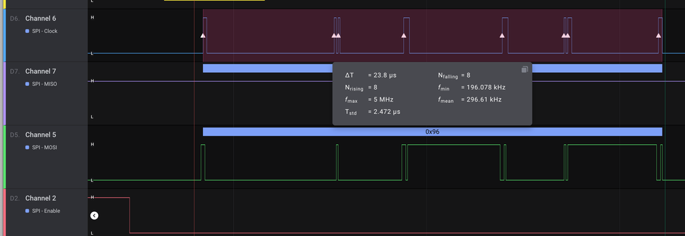

I am communicating with a TFT LCD and trying to speed things a little bit. At the moment I dont have DMA library written, so I am using standard SPI mode.
I configured the SPI clock as 5Mhz on STM32F407 mcu.
My main clock is PLL on 96Mhz. With APB2 = 2 and APB1 = 4.
Not sure if relevant, but Flash latency is 6 CPU cycles.
Gpio port output speed on CLK,MISO,MOSI is set to Highspeed. (no difference with low speed).
What I am seeing on the logic analyzer is the gaps between each SPI clock. Measuring one byte transmission speed, I am getting average of 300ish Khz instead of 5Mhz.
I only have one interrupt running in the code and that is Systick with 100us tick.
EDIT: One thing was definitely wrong in my setup. CPU WS latency. As my PLL clock is set to 96mhz and mcu works on 3.3v, I had to set 4CPU cycles WS instead of 6 that I originally had. Problem still persists.

So what could cause the clock to chop like its showed in the attached image? I only showed one character (8bits of data). with inconsistent timing between clock cycles. I would expect burst of 8 SCK clock cycles, and then whatever time in between two characters ..
waclawek.jan
MM.1 told you above: slow software.
As a test, write a minimal program which only transmits some random data through SPI. Avoid Cube/HAL or any other "library".
I am not using cube/hal libraries. I am still puzzled on how would any library influence burst of the bits, in my case 8bits on SPI DR register. I could understand delay between 2 bytes of data. This is delay between individual bits of 1 byte of data.
waclawek.jan
Ah, sorry then.
So, you program is already a minimal one, which only transmits a single byte and then just loops indefinitely? If not, write such.
Try it with the default (reset) clock settings. If OK, gradually add features of clock. What's the primary clock source?
Is this a "known good" board like Nucleo/Disco? If no, try the same code on one of those.
Try different pins of the same peripheral, and/or a different incarnation of the peripheral.
Read out and check/post the SPI and GPIO registers' content.
